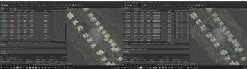

problem already reported but reported here for other confirmations. the correction data in Ntrip are stored only on the jpeg file in the dng file are not stored. obviously I shoot with dng + jpeg mode. attached the screenshot of the chuncks with photo alignment and error estimation

I have never mapped using DNG, also DNG takes longer to process, I would assume, you would have to fly at like 2MPH to collect data?
This will not be supported. Dng doesn’t have the internal xmp data and it would take to long to write the image.

It doesn’t store all that’s needed for RTK! RTK also needs to know gimbal and sensor location.
There’s no difference with any other RTK craft like this. p4rtk, m200v2 and m300.
mapping with RTK is about all about absolute resolution. Imaging is a second. Even with that said, the evo 2 final image is much higher quality than a p4rtk.

Once again it’s a processing issue. It would backlog the entire imaging pipe to do DNG and jpg.
regarding the p4rtk I know the system very well. I was the main US lead on field and beta testing on that unit. While yes, software is more refine it’s also been out since 2018.
as far as accuracy the Autel unit actually is on par and on some cases supersedes the p4rtk. as I tried to explain the Autel sensor produces a much cleaner image as well.
Once again, no system tags DNG images with RTK trigger information. If you want that you will need to go to a custom build, make sure camera speced can write DNG images in less that 1 sec and be able to cache. Next make sure the trigger and RTK system is up to the longer write times.
