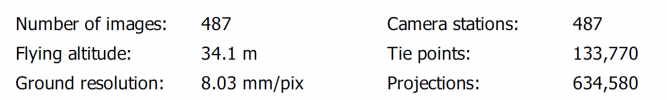

Flight height calculated by agisoft: 112ft

@jaja6009 Pix4D and mine Agisoft calculate similar and acceptable errors.
