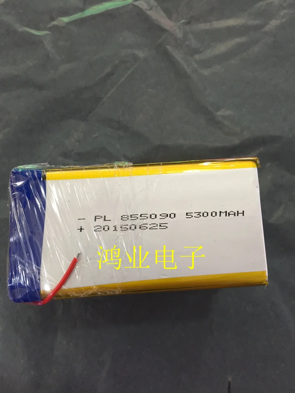

I have 2 housings. looking at a rebuild myself with bigger battery's. ship's from Thailand

You can try 18650. They fit in the bay. I think the important part is to wire the charging leads to show the cells. using the top of an old battery should give you the part to ident the battery as a known battery, to the system.
