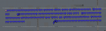

What’s the highest wind do you think you’ve flown in? And how do you think your EVO 2 Pro Ent performed?
The wind kicked up while I was out a little bit ago, and my aircraft started to drift away a bit. Didn’t panic but did pucker up a bit. I descended about 50feet till I got positive control back to me, and proceeded to land.
