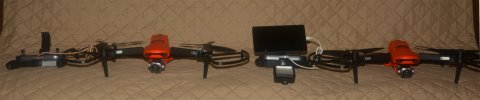

Where is the beef? In reality we two types of company.
A. A good company under promises and over deliver, makes us very happy customers !
B. Cunning companies over promise and under deliver to make a fool of us
The battery suppose to give 40 minutes, mine gives 31 to 32 minutes after a few cycles.
When flying 6 minutes remaining on the battery it automatically goes in to RTH mode.
That is 31 to 32 minutes minus 6 minutes = 25 to 26 real flying time, only !
Autel owes us all with EVO2 Pro owners one battery with a smile as a gesture of good will for short changing and pulling the rug over us.
The drone is indeed a killing machine and Autel should have designed a far better propeller guard and included it !
I have crashed two 6K drones and one got saved after crash from propeller guards that broke and propellers damaged,
when I called Autel and spoke to David, he refused to replace the broken propeller guards and propellers.
When I wrote to the Autel management, they Never Replied back ! !
After crashing two EVO2 Pro 6K I am even scared to fly as it boomerang around and came back to hit my son and then me ! !
What we need is proper Remote with 7 inch LCD built-in. and full support from Autel.
Autel owes me two batteries for I have two EVO2 Pro 6K.
We used Fugi cameras for wedding work, suddenly without any notice Fuji sent us a $600 dedicated flash ! !

Why so many crashes? Is there something wrong with the aircraft or controller?
What app sw & aircraft/controller/battery fw are you at?
Were you flying in mission mode or manual?
Inside or outside?
By chance were you flying with prop guard outside?
As for battery life, easily getting about 30 min per flight, granted thats 3/4 of the marketing hero number spec. However its also 2x better than what getting on my DJIs (they also play the hero number spec game). FWIW, I rotate five batteries so they get used evenly, have time to cool before recharge etc, total of about 200 flights across those. I also have my battery alerts set lower during warmer months and keep aircraft close to get more out of them. During cold weather, set the alerts higher and keep aircraft closer towards end of flight to help stretch the battery performance.
Hope you can sort out why the aircraft keep crashing.
