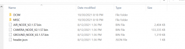

Formatted the card, unzipped, and copied 4 files. Same behavior, nothing happens other than the blue bar appearing. Waited 30 minutes on the splash screen. Here is all my current versions if it helps:

I have done exactly that 10 times. After a few minutes, the top picture appears. I have left it alone for 30 minutes and nothing happens. If I tap on the blue bar at the bottom, after about 2 minutes I get the bottom picture. I can tell by the aircraft lights that it is disconnecting about 1 minute into the upgrade process.

I hate to say this, and far be it from me to controdict what's been posted here already... but the Evo II Enterprise, has TWO drives that show on the PC if you plug it into the airframe directly... You get two drives that show up.
One is the flash drive, and one is the internal drive.
I don't remember seeing how you accessed the flash drive, (SSD card) but if you're plugging a USB cable into the Airframe for the file transfer, as I do... you need to make sure that the right drive is selected as they look similar.
If you put the files in the wrong one, it does nothing. The correct one for me (SSD card one) shows an Android folder... which I didn't see in your screenshot.... so...
Could be a super easy fix.
Plug your PC into the airframe with the airframe off... power on the airframe and then watch the two USB drives pop up in your PC My Computer listing.
Find the drive with the size that matches your SD card and has an Android folder, and put the files at the root of that drive.... then proceed to eject both drives, power off the airframe, unplug the cable and then power on the airframe with the smart controller powered on.

Appreciate the help, but I was actually removing the sd card and copying the files to it on my computer, so i'm sure its the right drive, and thanks for the help @Blade Strike! I will contact support this morning.
