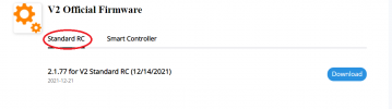

Ken. For those with both controllers, Is the protocol to install the new FW using the Smart Controller specific update using the SC and when completed, then reboot, then install the standard controller specific version with the standard controller? Also, there is no specific FW for standard controller on the Enterprise page. Is the firmware now unified?
Hey Dave -
I have been updating with the SC first. Once that's complete, I bind the standard RC and then use the standard v2 rc firmware to load that.
Thats correct, the v2 firmware AIRCRAFT fw is now merged. Please note that the RC firmware will always be different. This very important for everyone to know and fallow this.
Standard RC naming convention: Model-C_WiMax8020_FW_Vx.x.xx.zip
Samrt RC naming convention: Model-C_WiMaxPad_FW_Vx.x.xx.zip
