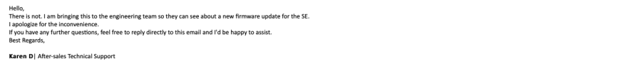

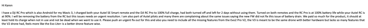

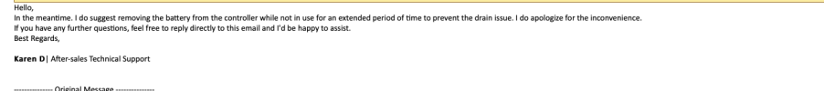

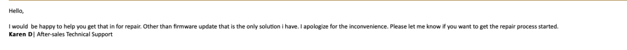

Same person responded to me as well. see the response first and then after I refused to accept a repair because the drone is new Karen responded again. At least they responded quickly now.
And They sent another email straight after this one.
