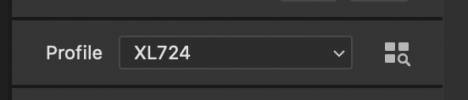

Open the DNG in Adobe Camera Raw. Under the histogram is the Profile setting
Click on the icon to the right -- the three squares and the magnifying glass. That opens the Profile Browser
