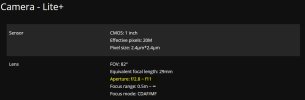

Just received my Evo Lite Plus, but I just can not find the manual aperture control. I was under the impression it could be adjusted manually from F2.8- F11?

According to the camera documentation you do indeed have manual Aperture control. No idea where it is though since I don't have that particular model. If it uses the same app as the EVO II 6K then you just hit the little up arrow in the lower right corner of the screen within the app, then scroll left (or right depending on where you are in the camera settings) and one of them will be aperture control.
