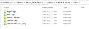

I am going back out this morning to shoot a small thermal survey at 200’ AGL and 90/90. I will shoot thermal only, rgb only, and thermal/rgb.
Reactions: jmason702
I am currently flying a 3.11 acres survey area at 7mph, 200’ AGL and 90/90 overlap. I will fly thermal only, repeat rgb only, then thermal/rgb. I will post all datasets to Dropbox later today.
