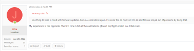

Why did you re-calibrate everything after you did the update? Did it ask you to? I never recalibrate unless it directly asks you to. I think it says somewhere don’t just re-calibrate because you feel like it needs it. I don’t know if this has anything to do with it but just curious why you went through the procedure on all three. I also wouldn’t just fly up until you receive homepoint, I would stay more towards the ground until homepoint has been announced. Lastly, if my drone was ever in trouble, the pause button would probably be my last choice in attempt to stop a crash. I would definitely try to manually divert the drone by using the sticks, even in a RTH sequence, it should still respond to the sticks if used. Regardless, sorry that happened.. a crash is always a bummer, but hopefully in the end you learn something if it’s not just a software failure, which can only make you a better pilot
Thank you for your participation. I have done most of the actions you criticize and it is described in my post. Unfortunately, my speaking in English is probably poor. After entering RTH, the drone control stopped responding to any instruction from the controller. In the pictures from the LOG that I have attached, you can see that during the entire flight I kept the right stick in the left position, which is nonsense and it is strange. And why did I calibrate? Personally, I find it logical. When other than during such a significant change as a firmware update? I have read about this necessity several times from the posts of more experienced users, the last time it was also in connection with this update. If it was not necessary or prohibited, the manufacturer would probably not make this option available.
