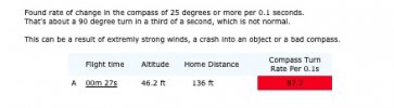

No significant drop in voltage. Battery was in green. Battery temp went from 57.5°f to 71°f Outside air temp was 5.5°c. Signal was good. Compass however went mental. 87.7 rate of turn. There was little to no input from me after 27s in.
The compass was out of whack!!!
I did a flight straight after the crash to test everything and it's all in the green.
So something sent the compass mental on the first flight.
