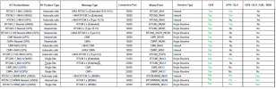

I'm using a VRS Service Masscors
Account settings requested in app
Ntrip Host: I have this filed out correctly it was shown in my Masscors account clearly
Port: 10000 same as above
Account: username and I checked that it work in login with another device
Password: same as above double checked it worked on another device
Mountpoint: Here is where is gets interesting if I use the Mountpoint supplied by my service provider which I believe should be RTCM3MSM_IMAX it wont loggin but if I use the IP address it will login and say connection successful....
On other devices that use NTRIPs ive put the IP address and port in the same field separated by a /....
thanks by the way this is all super helpful guys

Your Internet DNS provider is not resolving the url for your Masscors account login address, but the IP address does not use DNS. This is unrelated to the Mountpoint name. Hope this helps.
