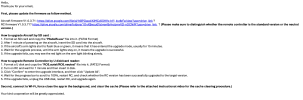

Ok, from the time I received my craft, it's only gotten airborne one and in that, the camera wasn't working. Thereafter, I reached out to Autel Support and they had me upgrade the firmware on the craft and also on the Remote. My Autel Evo 6K enterprise came with the Smart Controller SE. Once the craft upgraded, I began getting the message Real-name registration of UAV. According to national laws and regulations, real-name registration is required before unlocking for takeoff. Autel has since given me the following code version that has remediated that problem but I still have no working camera with this version. My belief is because the versions of fireware aren't proper my craft cannot be airborne with a functioning camera. I ask you, if you have a functioning Autel Evo 6K enterprise and if you could share with me the versions of firmware for the craft and the remote that I can load onto mine. Here are some screen shots from the software that's presently on my craft. See Attachments.... Can you examine your craft and see if your versions are different than mine?
I checked all the information that you sent and it matches mine.
