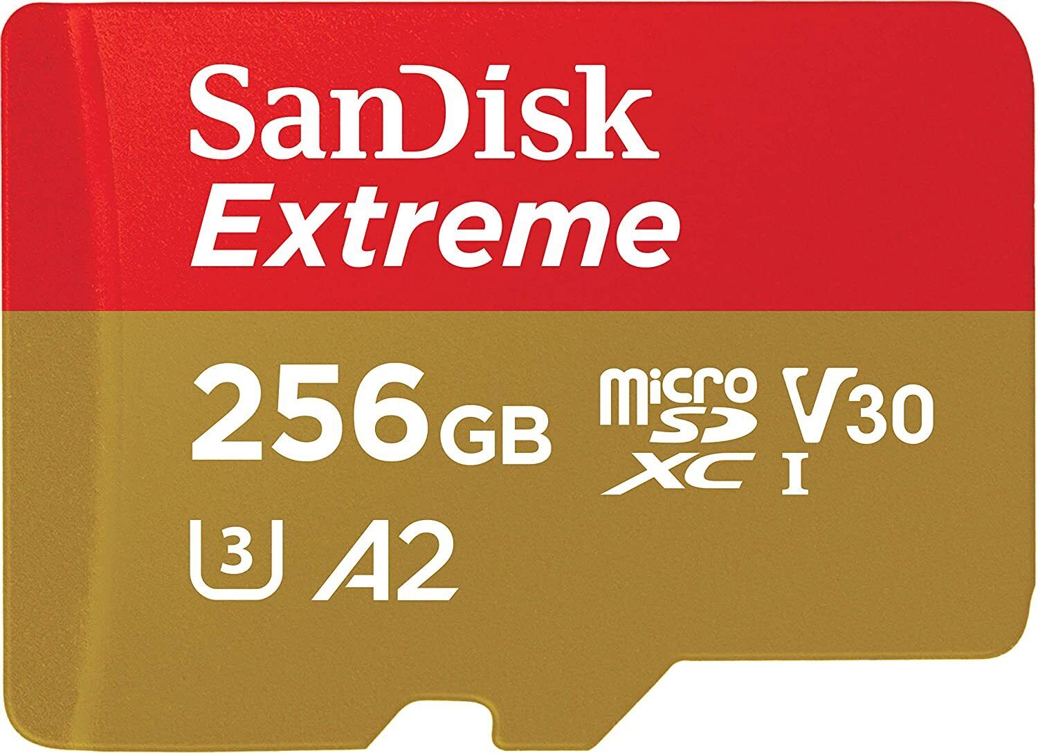

I did all three updates and then put a 256gb SanDisk 256GB Extreme microSDXC UHS-I Memory Card with Adapter - Up to 190MB/s, C10, U3, V30, 4K, 5K, A2, Micro SD Card - SDSQXAV-256G-GN6MA from Amazon and I did not even have to format it. The drone immediately recognized and I had no issues. Have already flown twice and put appx. 60 gig of photos / video on the card. They were $25.99 from Amazon.
