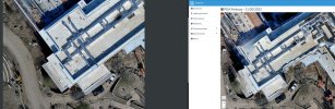

Hi All,
EVO II Pro 6K Enterprise V2 with RTK
I think this is a very interesting discussion. I recently started mapping with a 75/65 overlap at around 18-20 mph. I notice some jello or distortion in the ortho, but no more than I have seen with the M3E output, data provided by Billy Kyle and Dylan Gorman. I looked at all my photos and notice very crisp and sharp images every time. I believe it's a software processing limitation, not speed or electronic vs mechanical shutter. I also make sure to keep my shutter speed between 1000 and 2000.
Left is original image, right is processed ortho.
Regards,
Gerry
