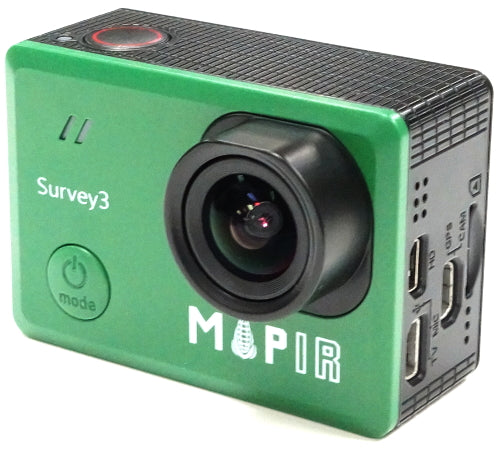

ah well thats good to know, I am currently using an Autel Evo II 8k for work. I keep hearing things thrown around like using an NVDI camera and I was under the impression that you could get better results with a camera that specializes in that.

Micasense is probably the leader is small NIR cameras. Unfortunately, they are more than $1k new.

You can do a lot of photogrammetry with the integrated RGB camera of the EVO IIs, particular structure, topo, 2D/3D, even basic plant health. However if you are looking to do more advanced plant monitoring, you would want to explore adding something more than just the built in RGB camera with multispectral capabilties such as near infrared e.g. NDVI or similar. Have seen an add on camera/payload for doing NDVI with Autel EVO IIs advertised on this form, however not yet tried using them.
Correct, if all you are doing is basic photogrammetry, with a little bit of basic plant health, the built in RGB camera on the EVO IIs will do fine. However if you are looking to do more advanced plant health monitoring or other multi-spectral projects, then you would need to add another camera usch as for NVDI, or other sensors for what you are looking to do (e.g. thermo/IR, etc).

If you have no need to do therm, then dont worry about spending around $6K for a thermo or radiometric camera. Otoh, if all you are doing is enhanced plant plant/vegitation photogrammetry and want to get into multispectral (e.g. beyond just using RGB), have seen some affordable NVDI type add on cameras in this forum and elsewhere.
I looked at that one I think that is the one that I am going to end up using now the question is what type of software would be ran to analyze the data that the Drone collects currently I am using webodm but I have heard of qgis I have tried using it but I am curious about if there is a better package for handling the data
You can use webodm with qgis
For example: Tutorial: WebODM: Use the results in QGIS
