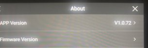

Just now did a screenshot off the V1 SmartController, most recent is V1.0.72
Hope this helps, and looks like you got your SmartController back to operating.
I know, can easily get things screwed up uploading wrong version.
Happy Evo 2 flying to you and all.
